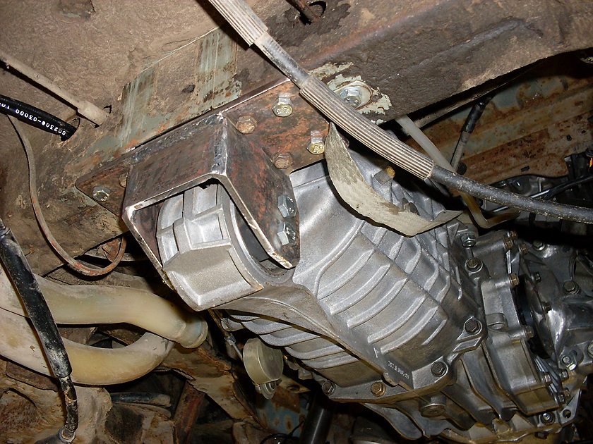

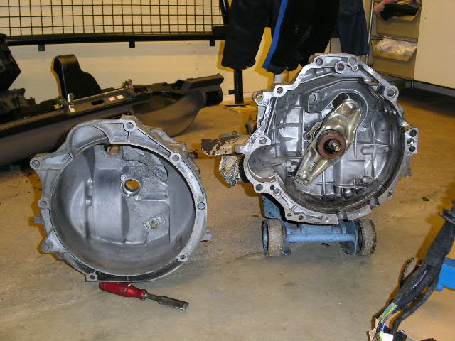

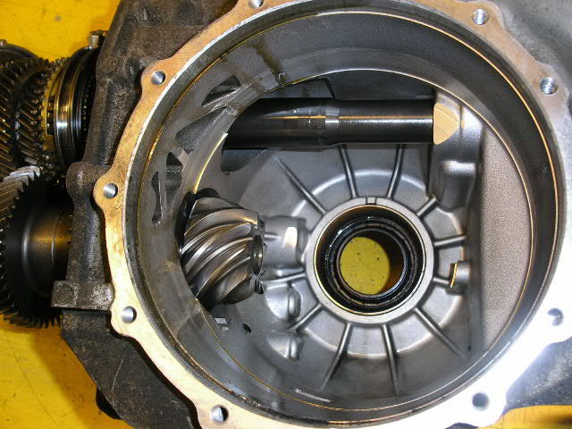

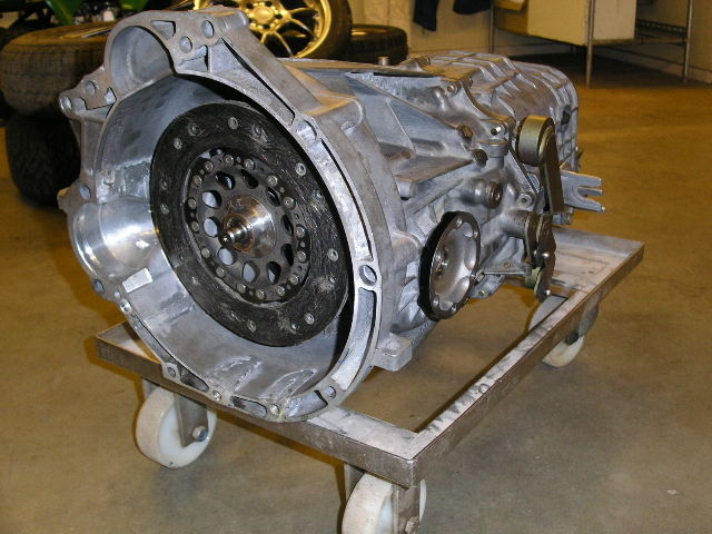

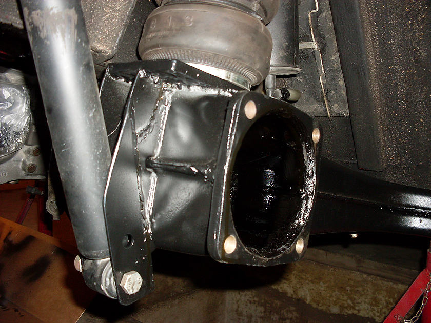

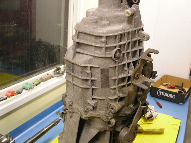

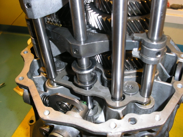

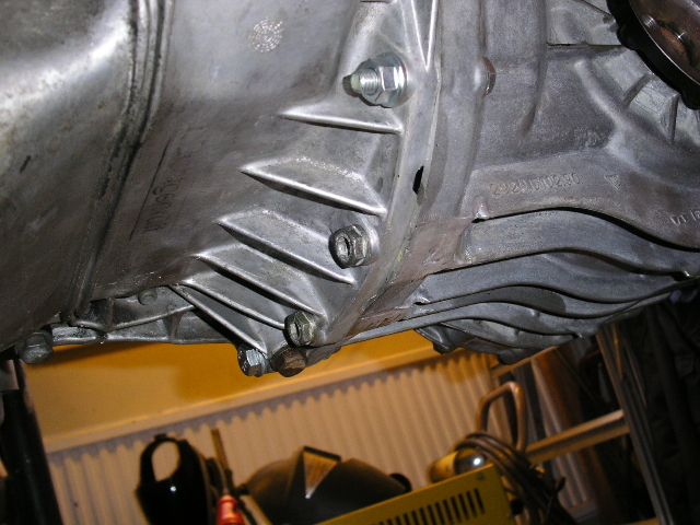

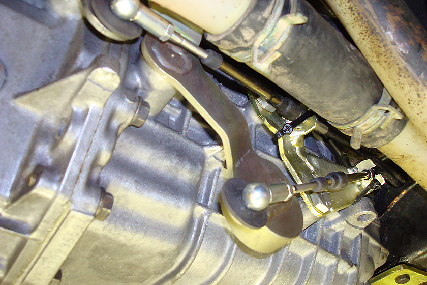

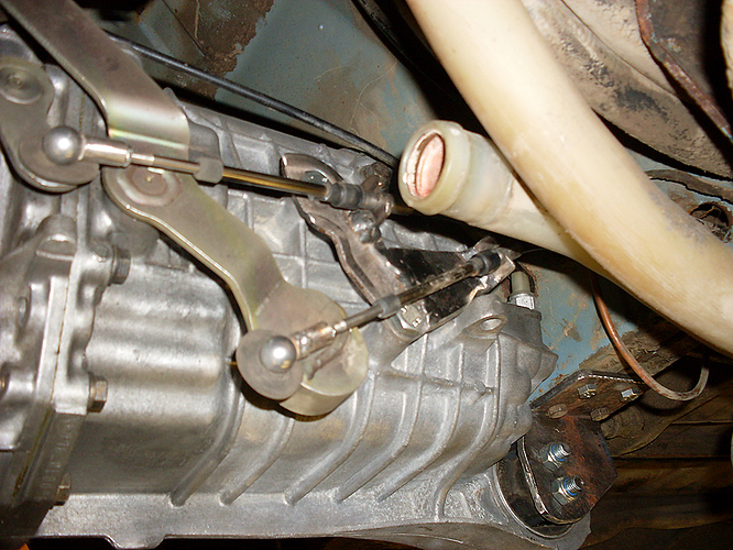

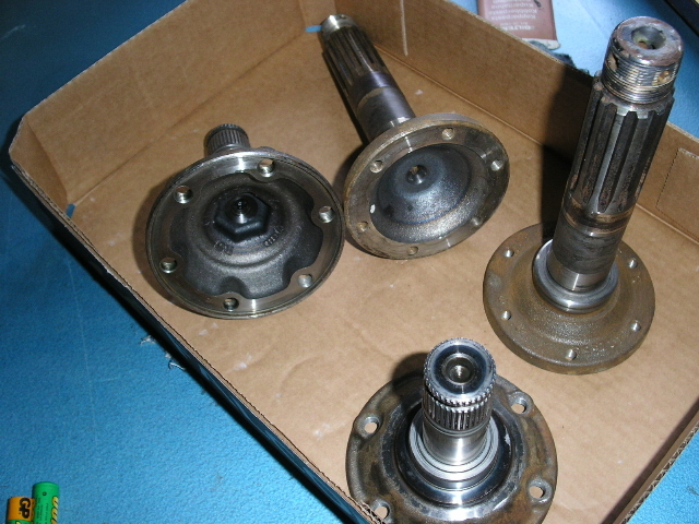

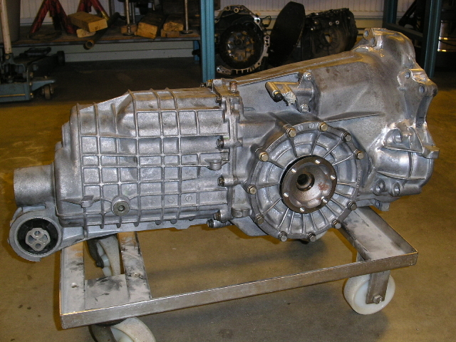

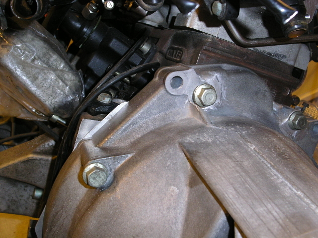

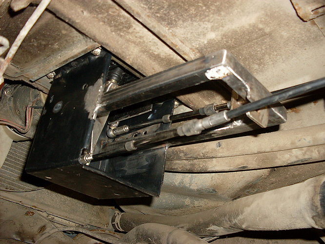

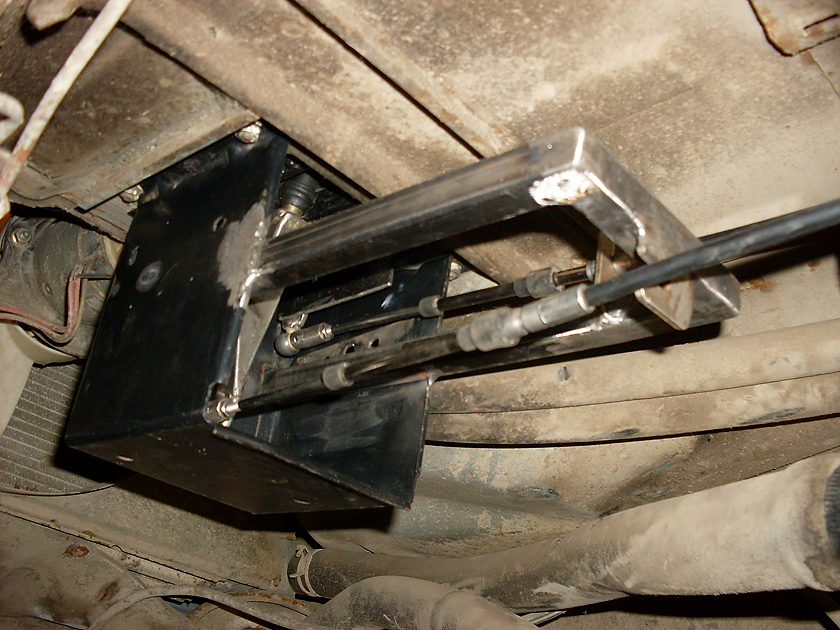

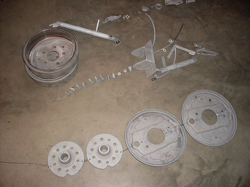

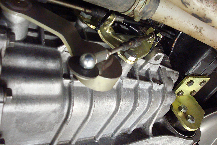

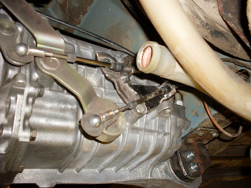

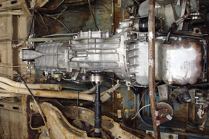

Pictures on the Porsche 996 gearbox.

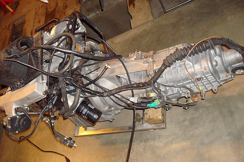

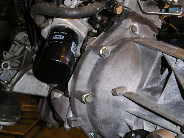

Porsche 996 to Left and Audi to Right
Porsche 996 in front and Audi in rear.

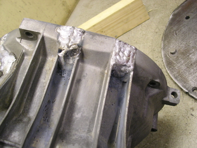

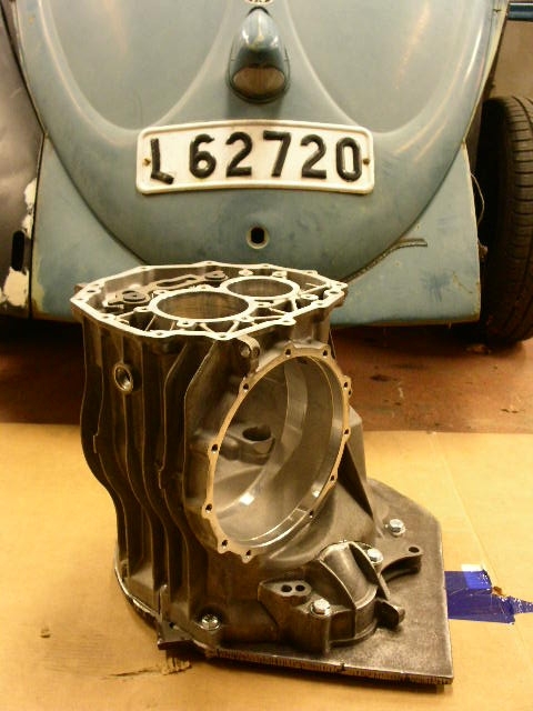

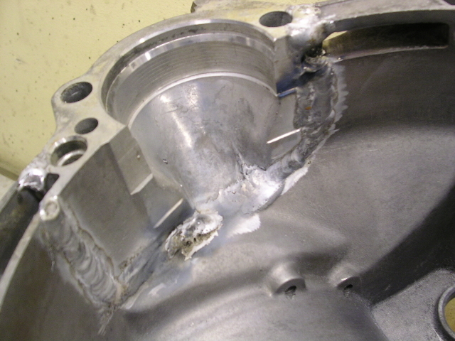

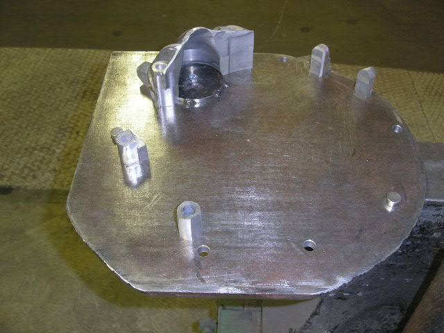

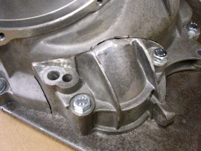

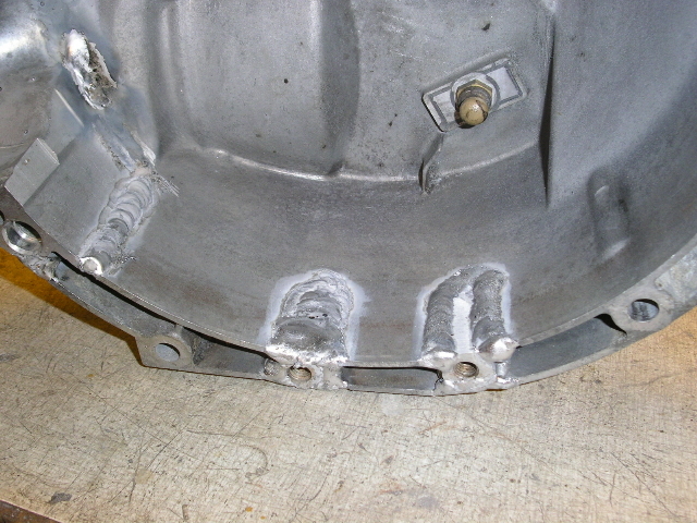

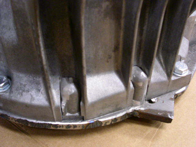

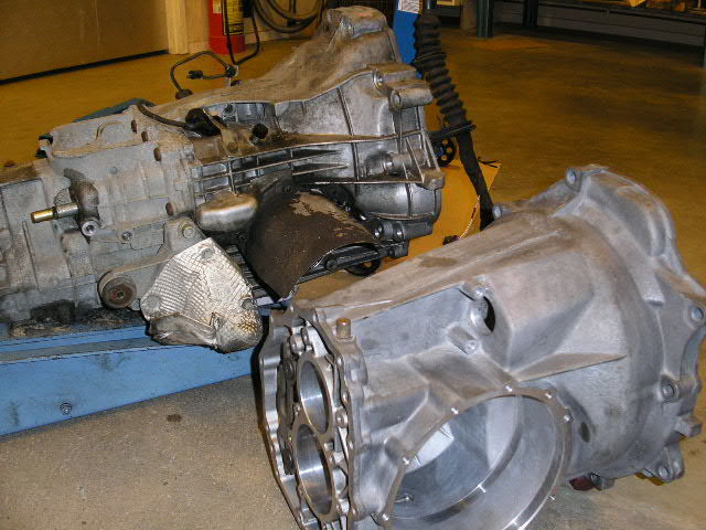

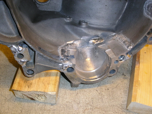

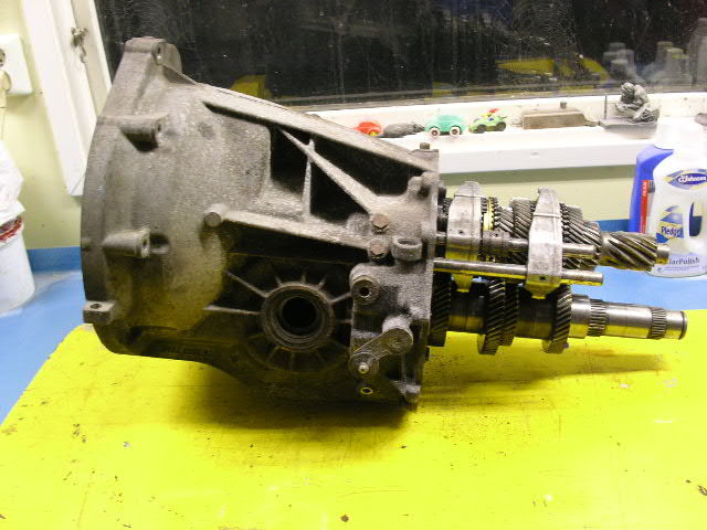

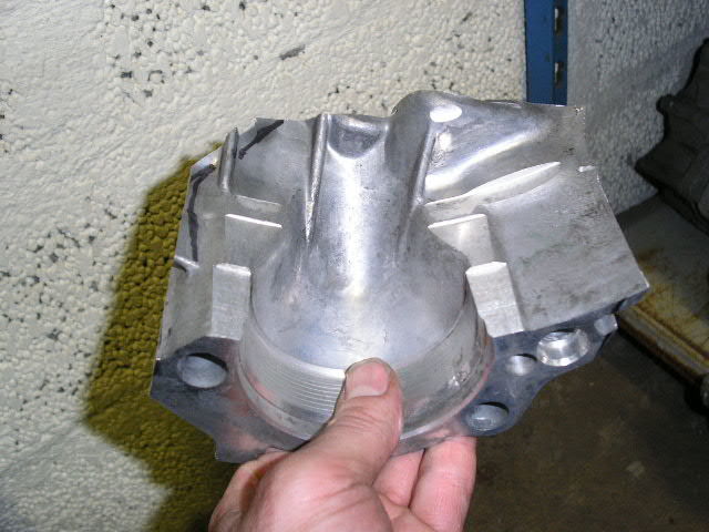

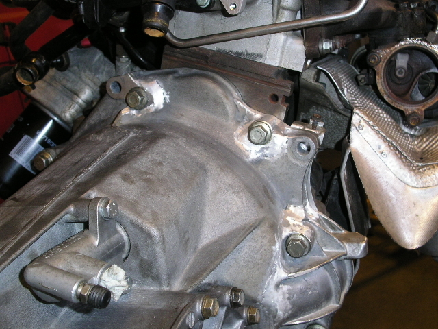

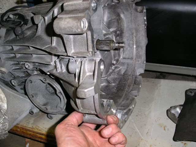

here we cut the piece from the Audi gerabox to weld on the Porsche
gearbox to mount the start engine.

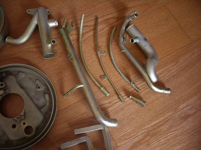

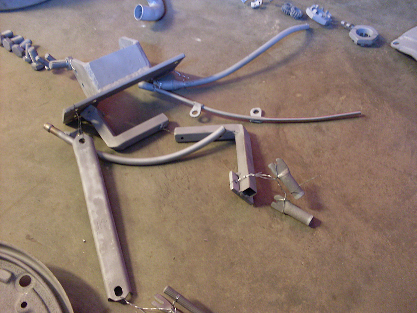

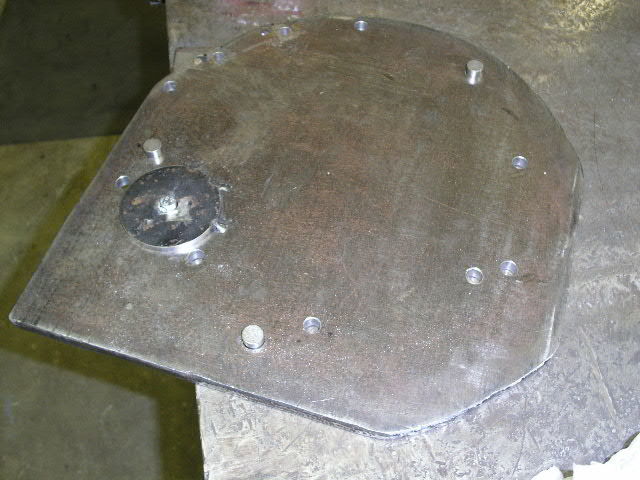

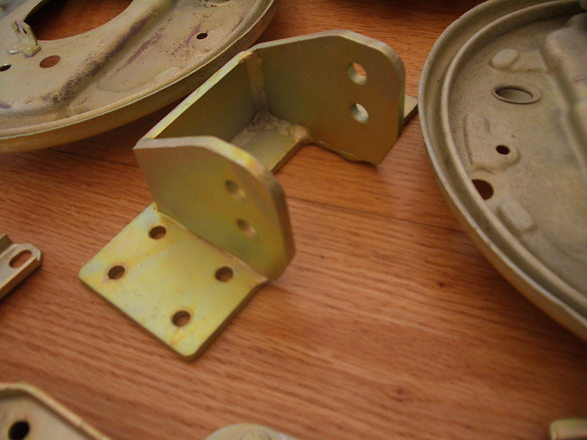

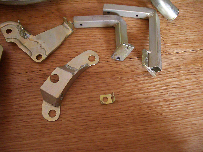

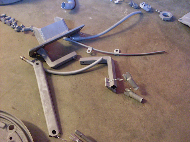

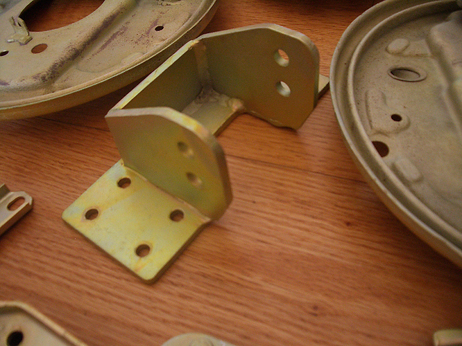

Here is the piece we need
Here is all piece that have to be welded on the Porsche geabox to mount an Audi 1,8T
Best regards Patrik
vw-tristar.com

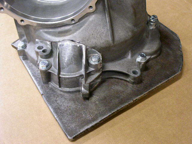

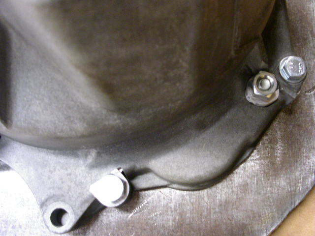

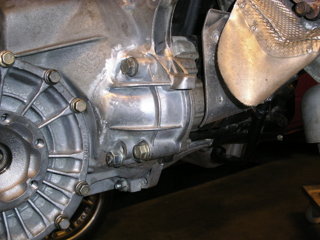

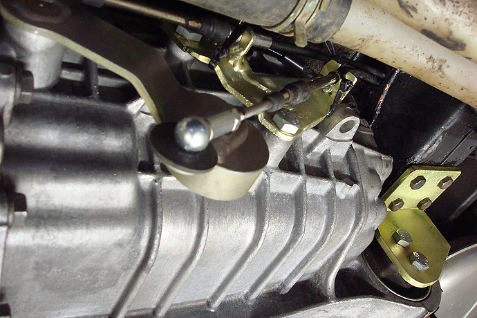

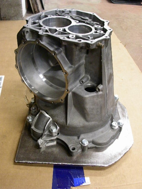

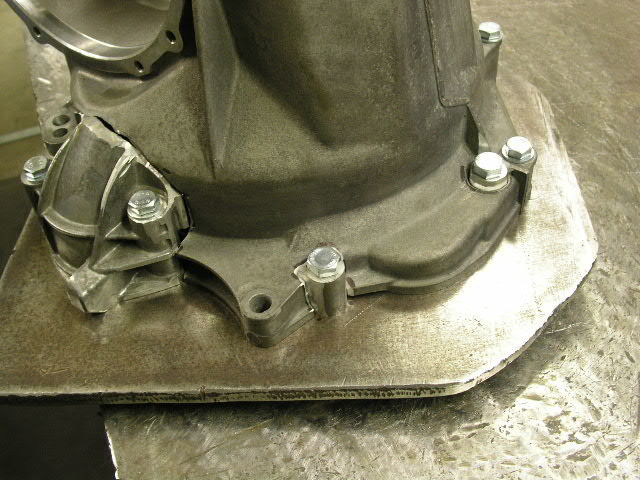

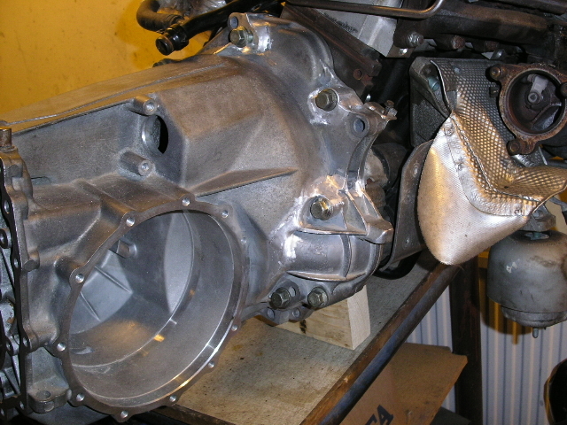

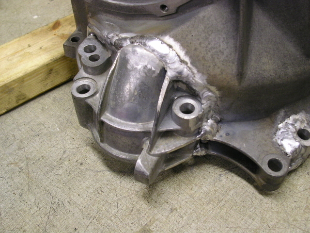

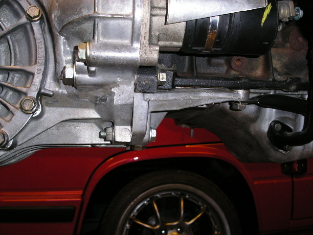

New fasten on Porsche gearbox to bolt the Audi 1,8T engine.
Now it´s readay to get welded.
Best regards Patrik

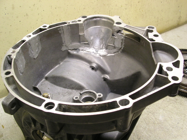

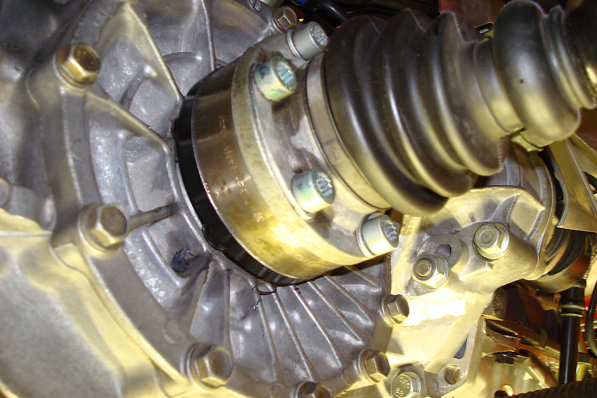

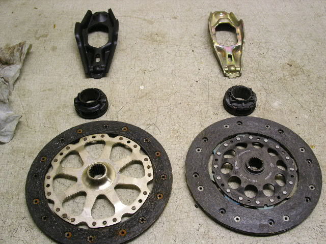

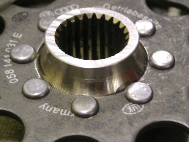

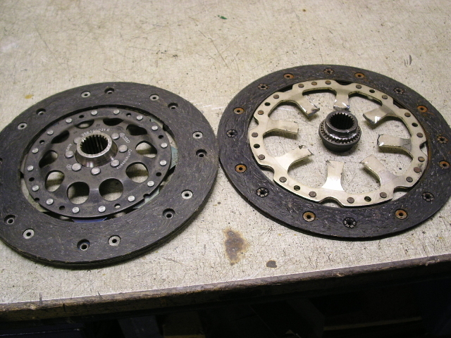

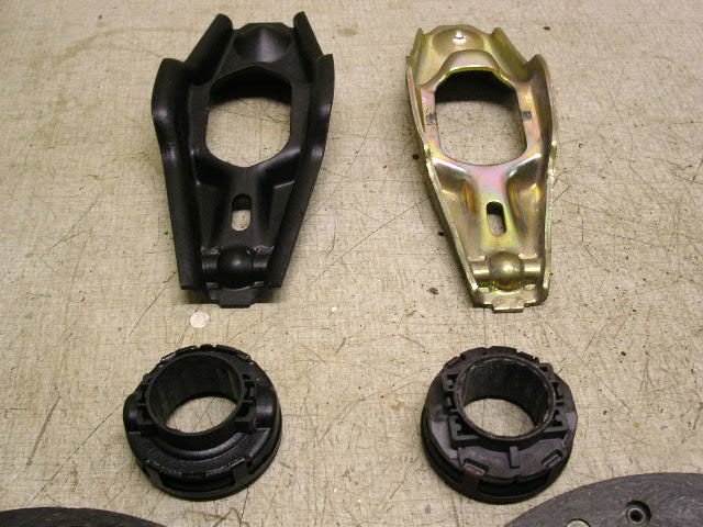

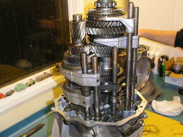

The clutchcenter from Porsche must be cut out and weld into the Audi clutch.
Porsche to left and Audi to Right
Porsche to left and Audi to right.

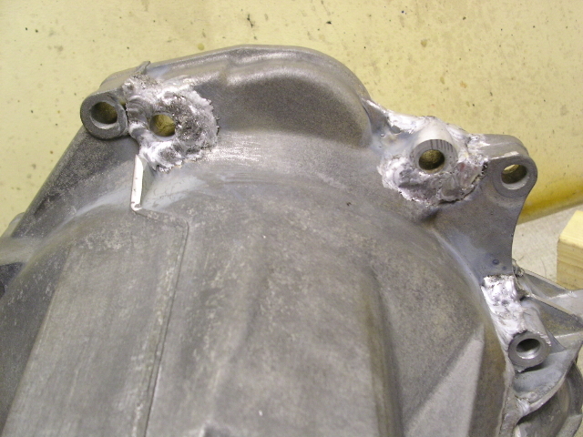

Now back from welder.
Best regards Patrik

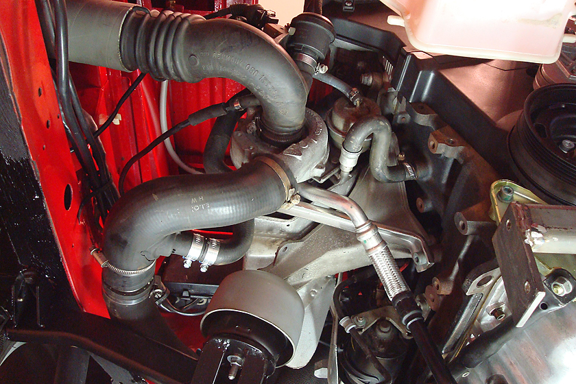

Now is the Audi 1,8T engine and Porsche gearbox is in our testcar.
Before we install it in our TriStar.
Best regards Patrik

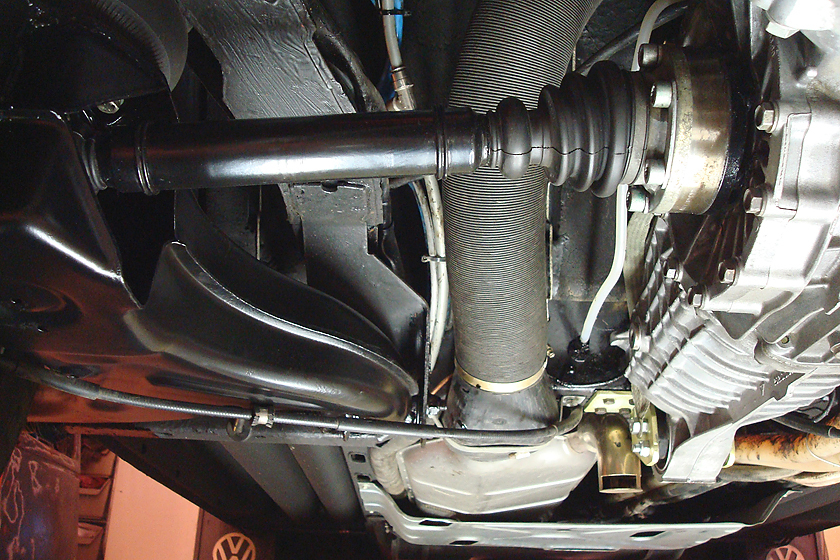

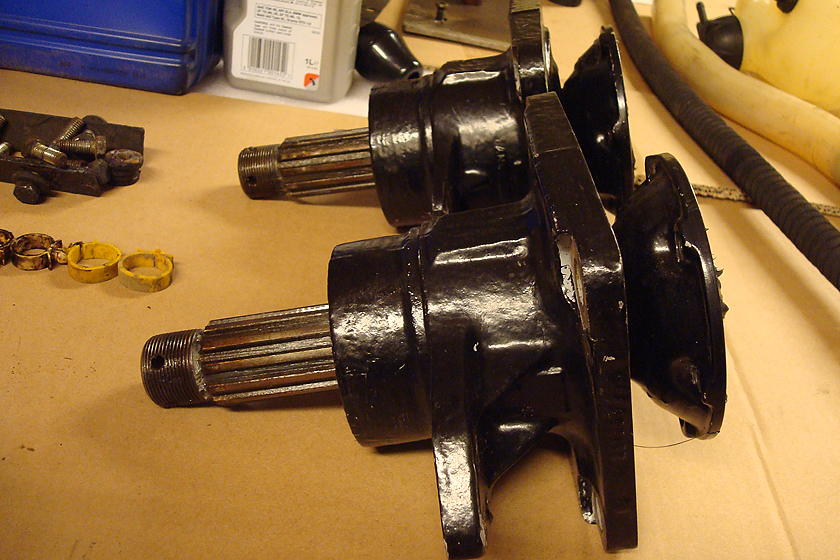

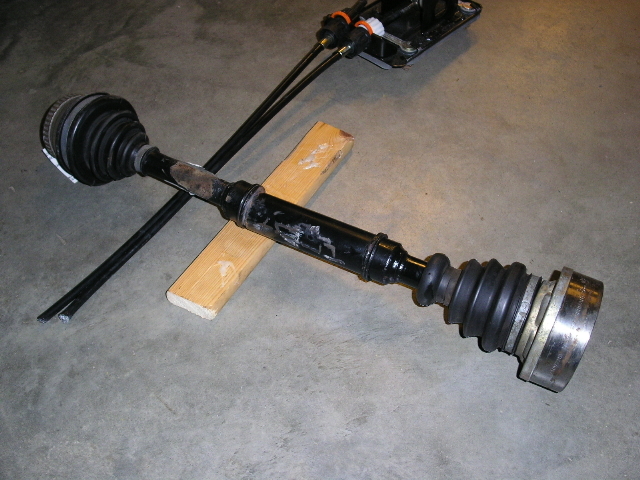

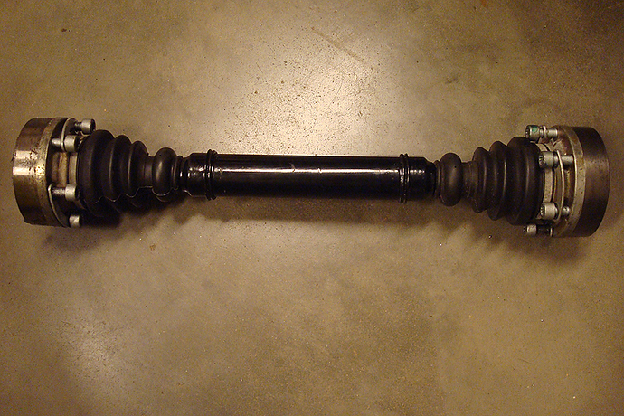

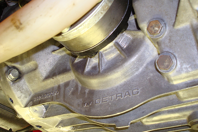

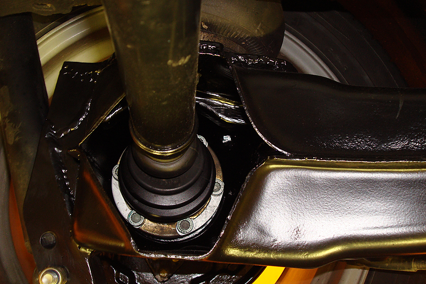

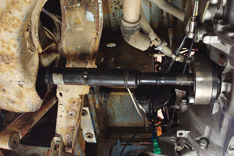

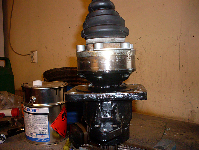

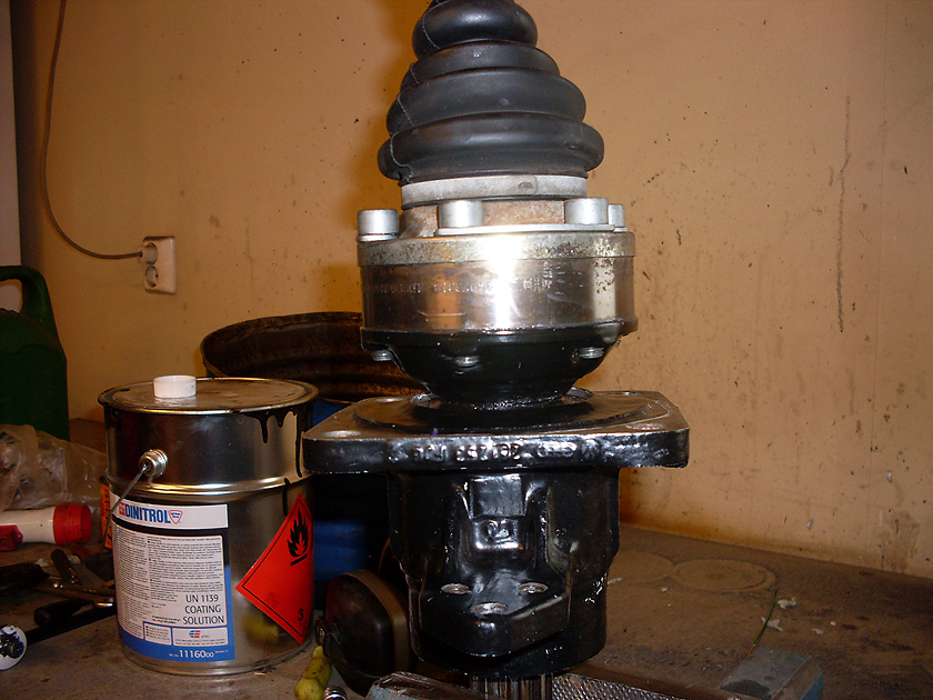

Bigger driveshaft and CV from Audi Turbo.
Audi fit right on the Porsche gearbox.
But the other end need some weldingjob.
Best regards Patrik

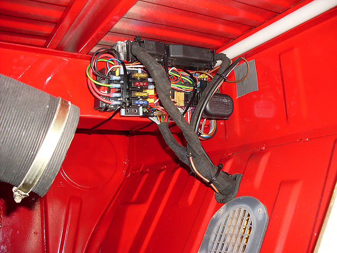

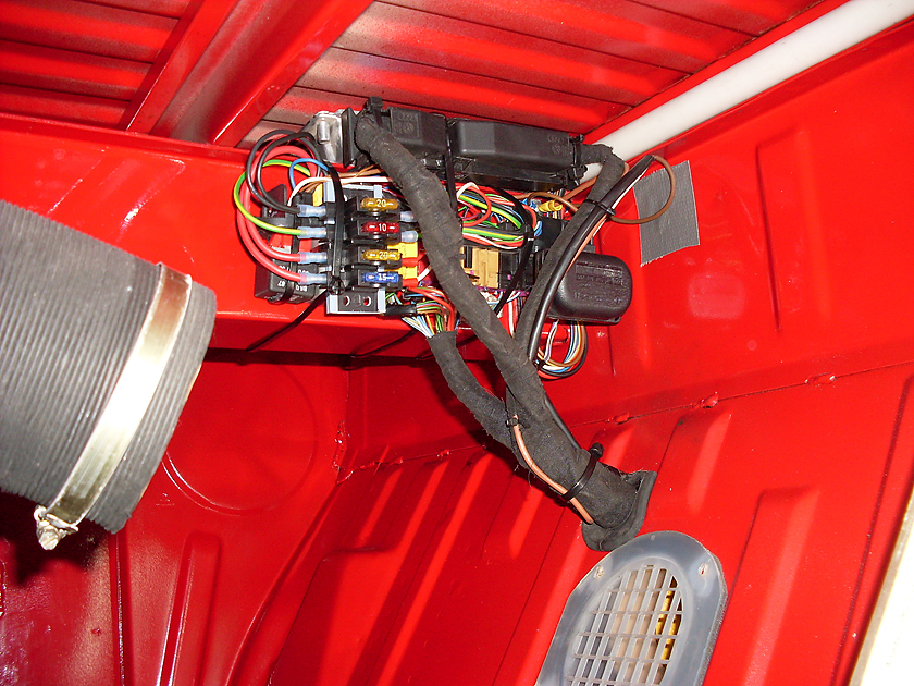

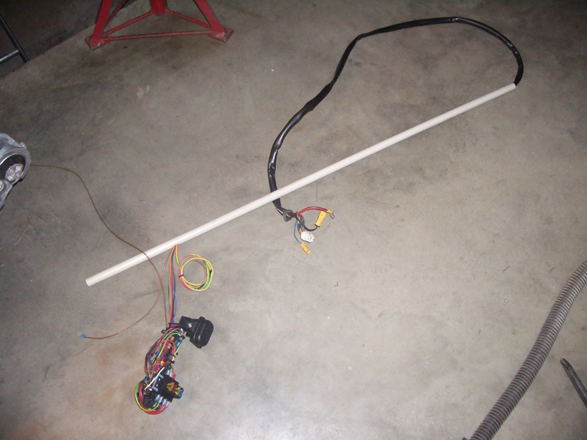

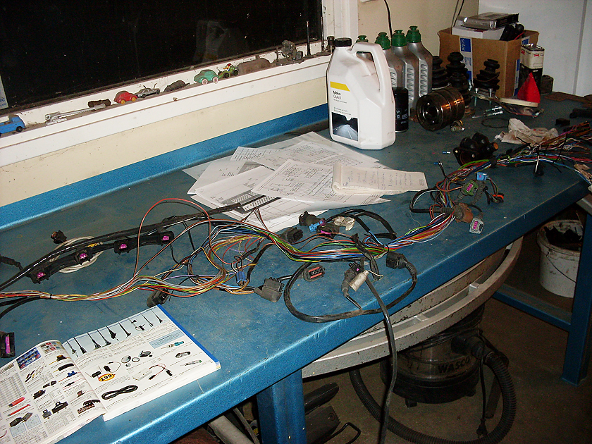

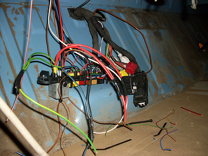

Some wire job to.
Best regards Patrik

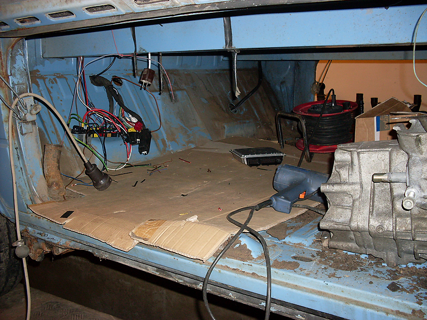

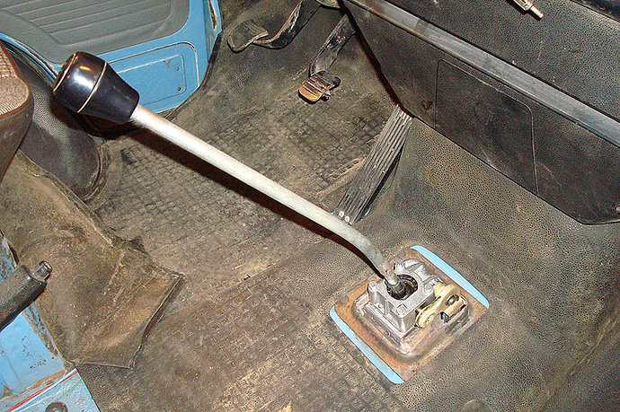

The built is done.
Now shall all parts be painted and put in our TriStar.
Best regards Patrik

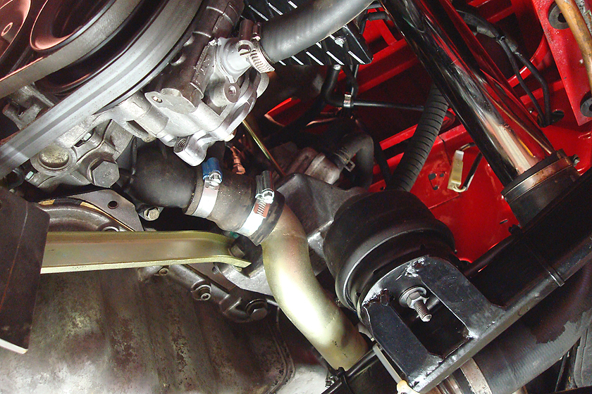

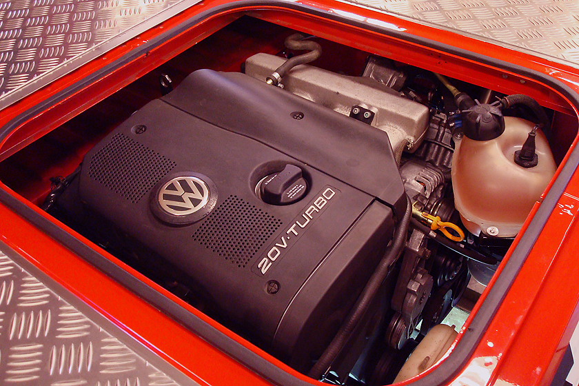

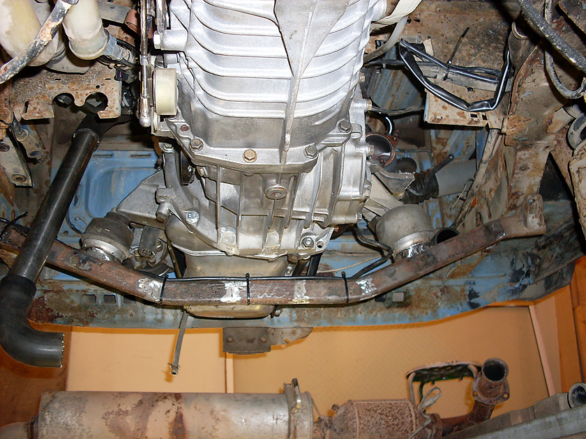

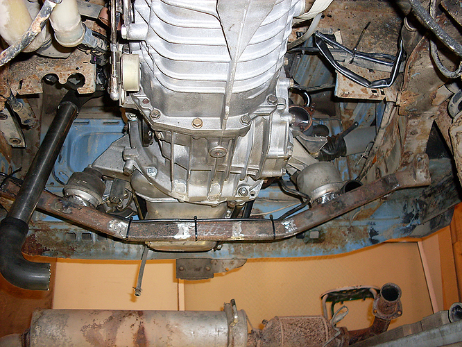

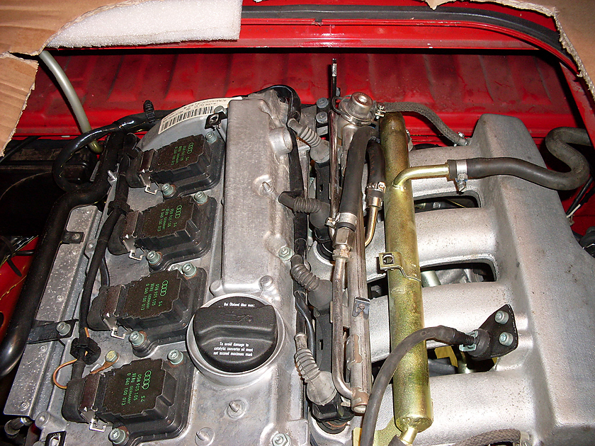

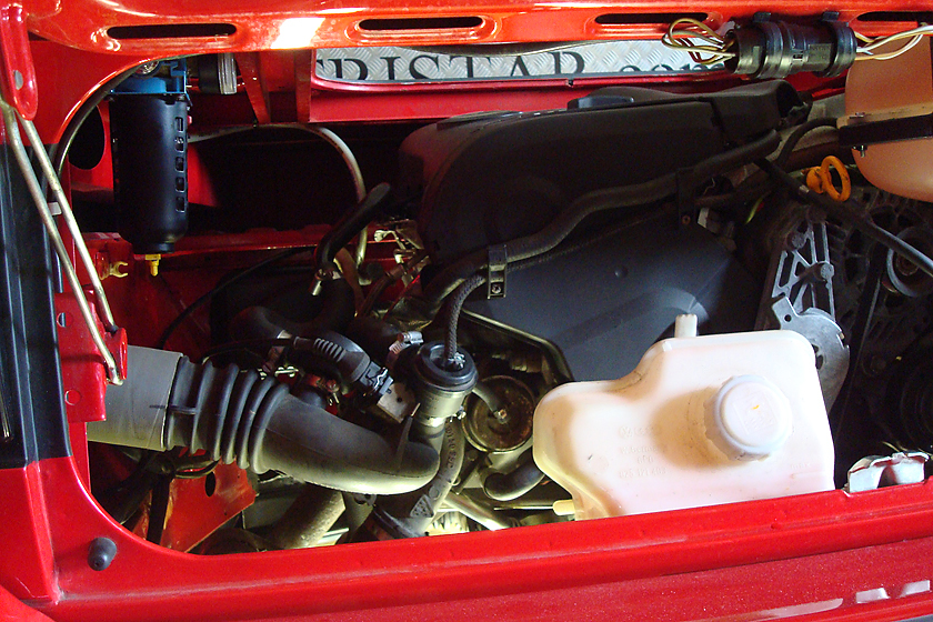

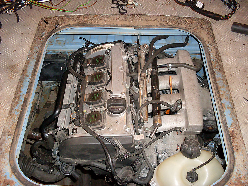

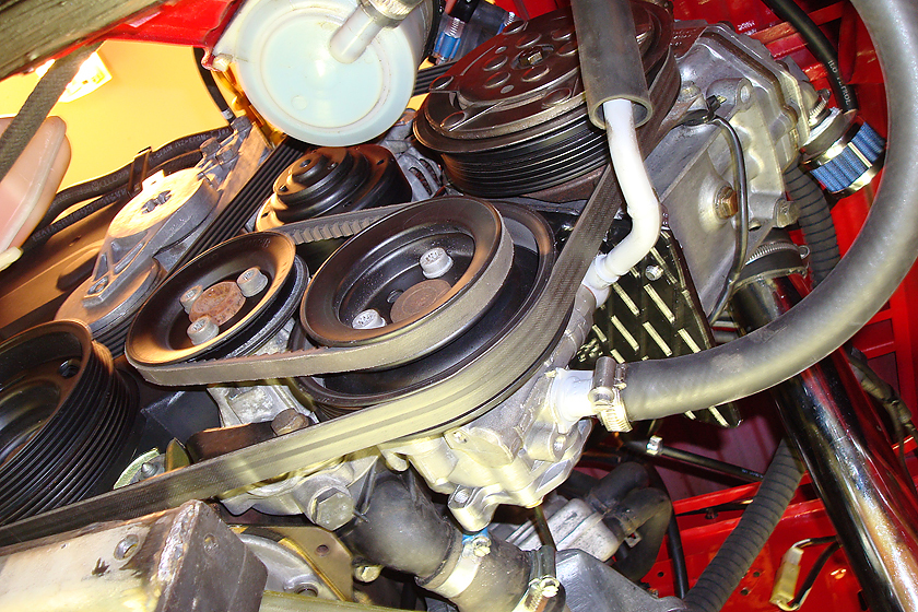

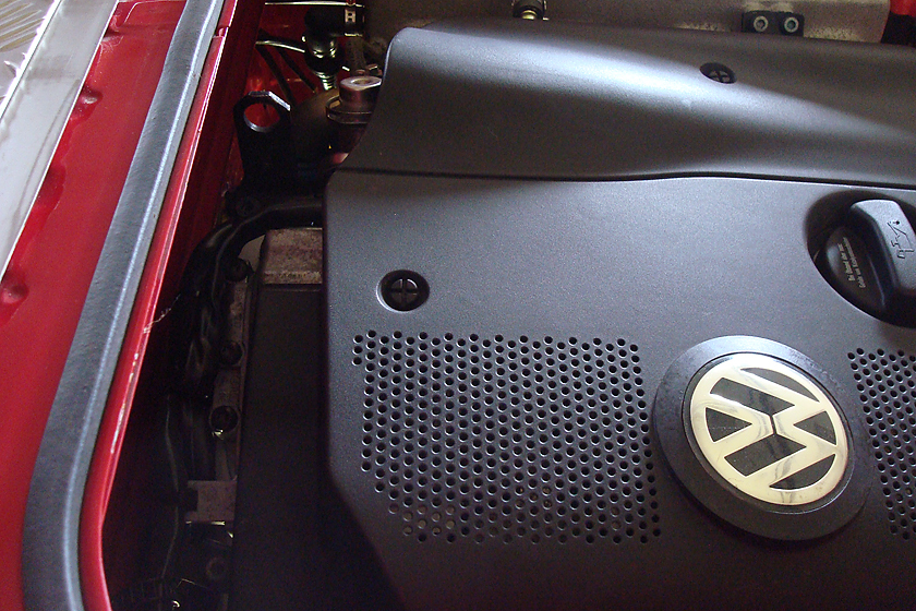

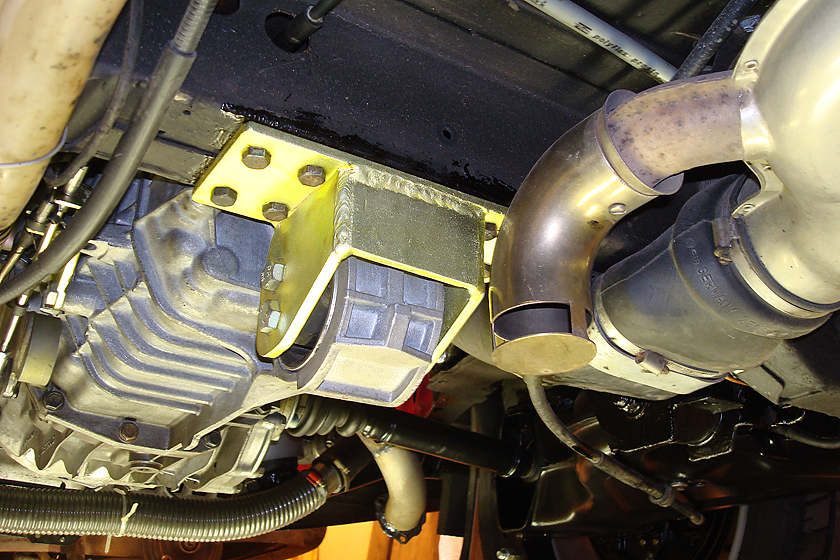

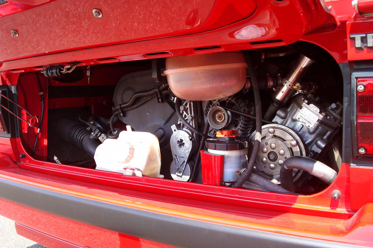

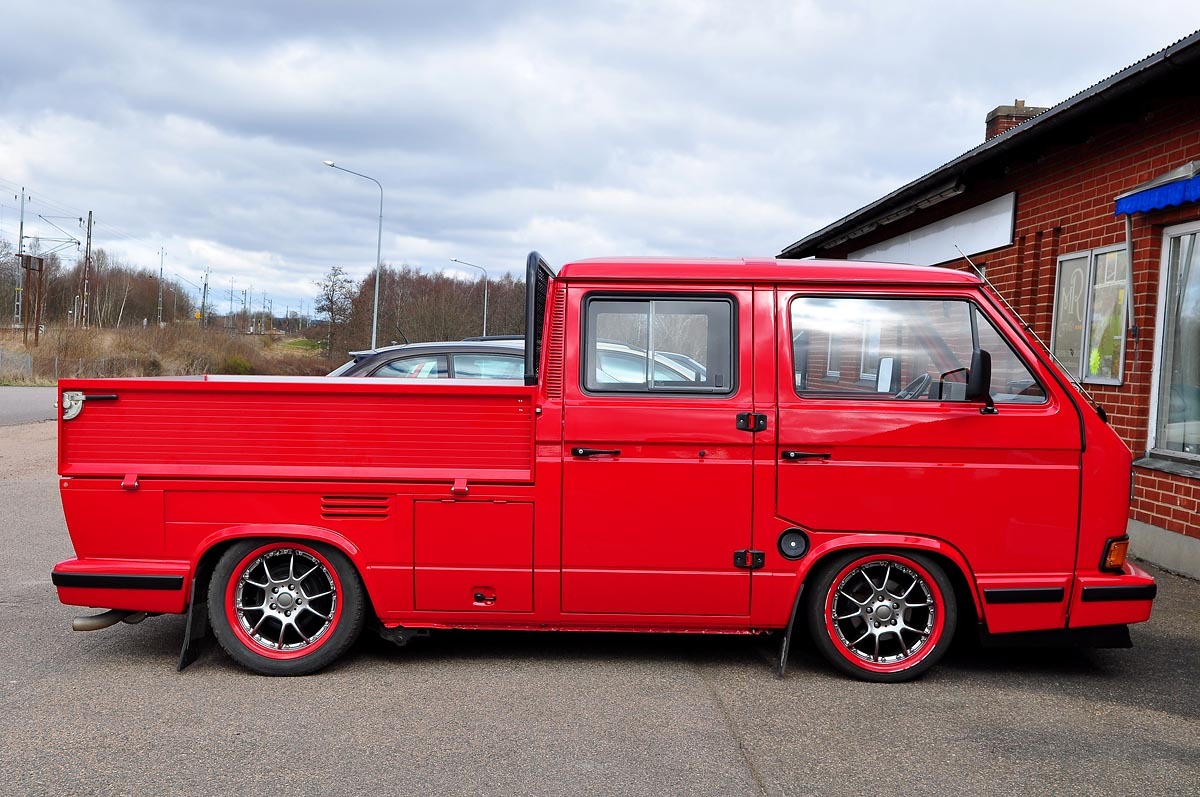

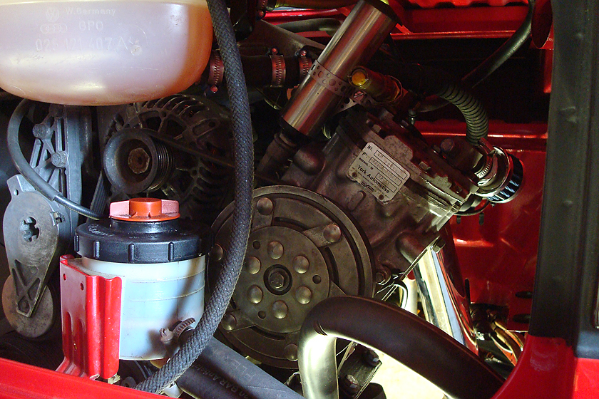

The Audi 1,8T engine and Porsche 996 gearbox in our VW TriStar.
Best regards Patrik

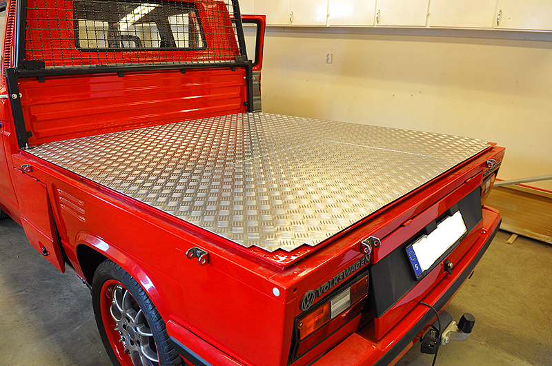

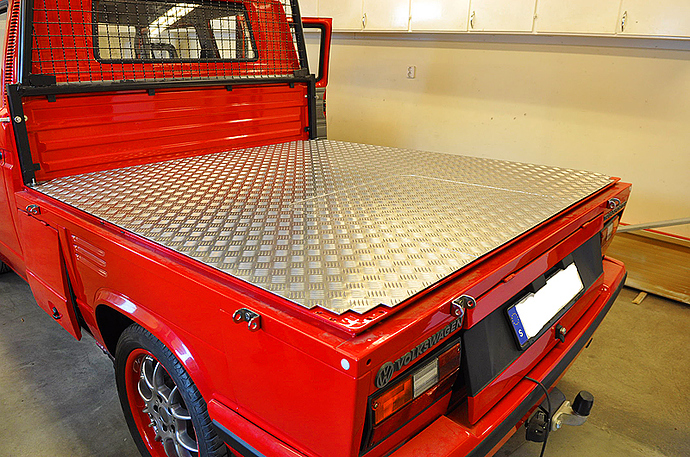

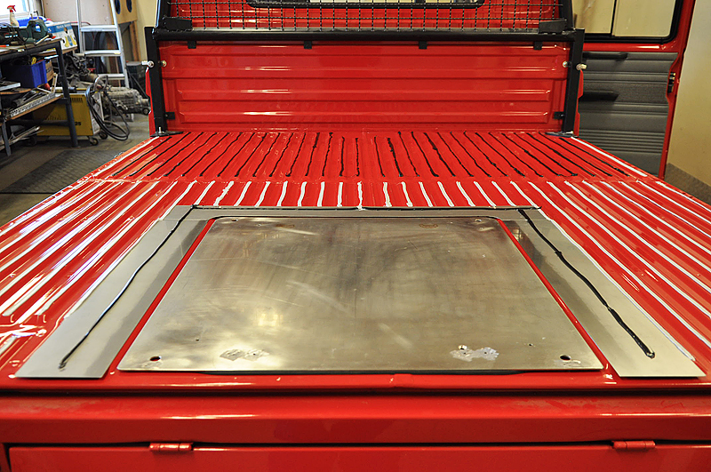

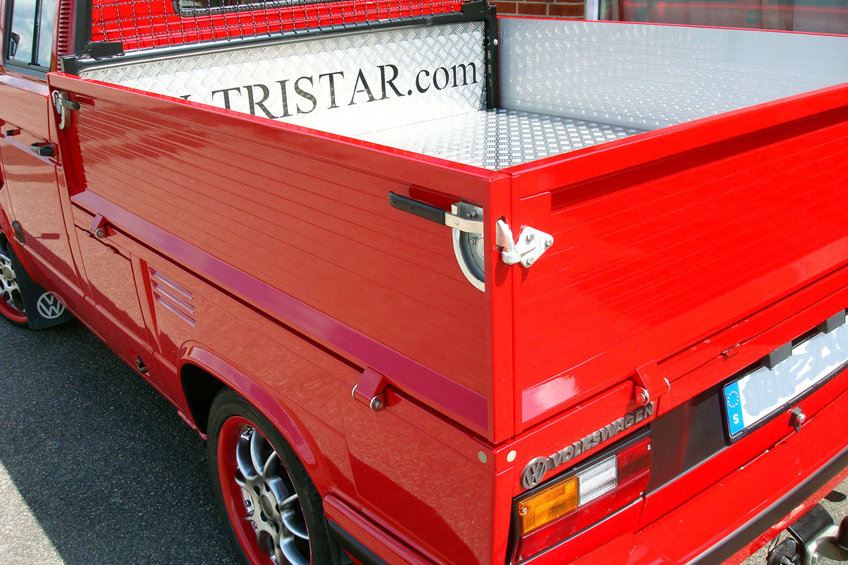

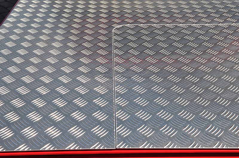

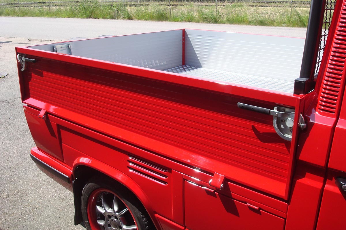

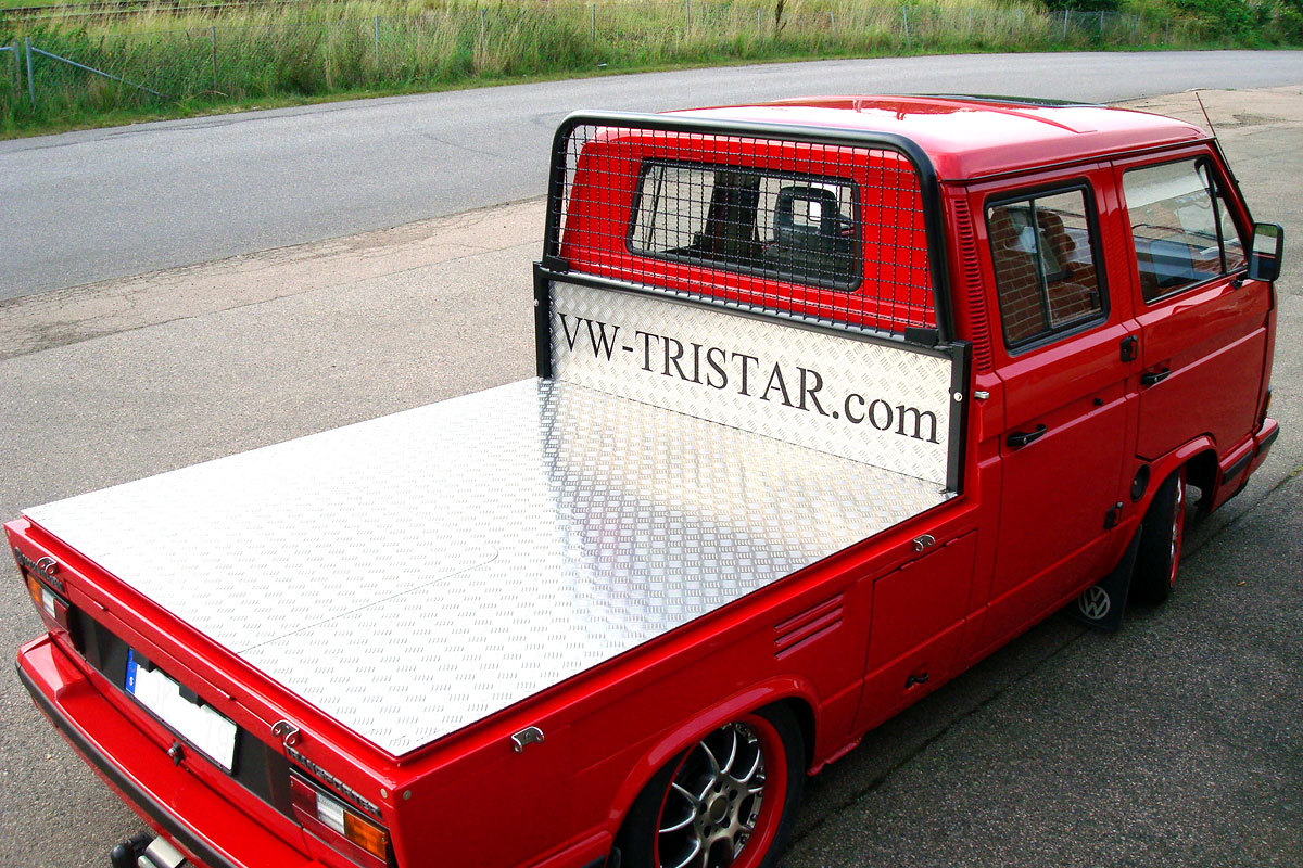

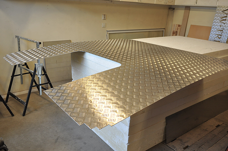

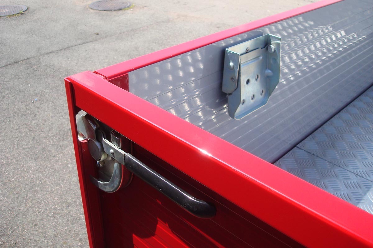

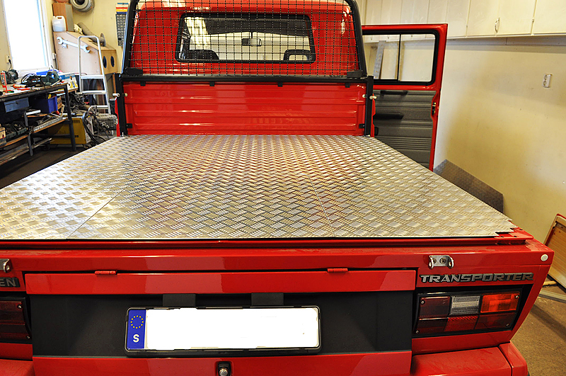

New Aluminium in the loadbed.
Best regards Patrik
www.vw-tristar.com
Best regards Patrik

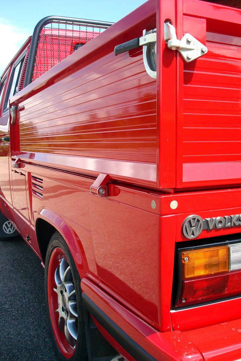

Now its ready!
Best regards Patrik
